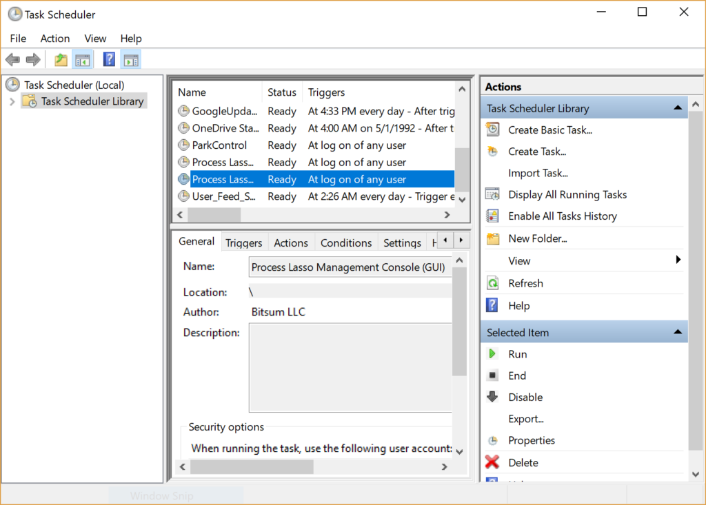

Once you open the Task Scheduler, you’ll see it has a hierarchical structure that few presently use, but Process Lasso is in the root folder (so you see it as soon as you open it). Now, you will see TWO, one for the governor (core engine) and one for the GUI. They will be clearly described. The screenshots below show the modification necessary:
Finding Process Lasso GUI in Task Scheduler

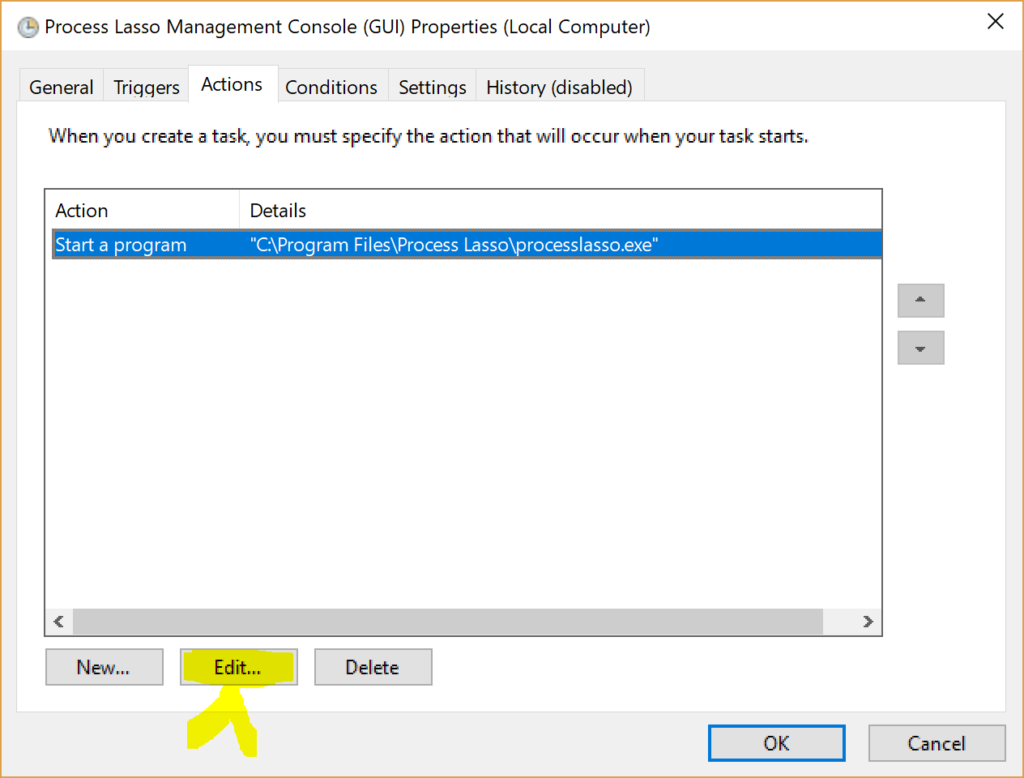

Editing the Lasso GUI entry
